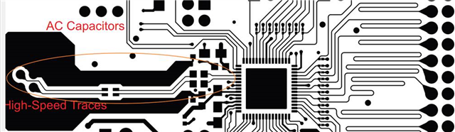

1.The attachment is for the DS90UB926Q schematic and PCB Layout, please help to review it!

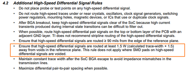

2.What is means of below orange line means? The EVB also use SMD Pads and the track also > 1.5W, please help to confirm. THX
