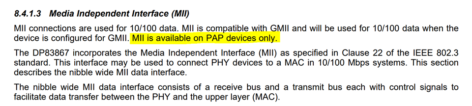

I am trying to use the QFN package in MII mode, but without the TX_CLK pin I do not know what clock to sync the txdata to. Is the GTX_CLK? Because I've been trying this and getting inconsistent results...

Hello Joshua,
MII is available on PAP devices only and not on RGZ devices.
Gokul.
Ok. Is the RGMII at 100 mbps essentially the same as a MII interface? Or do you need to run MII mode to get 100 mbps? Specifically talking about subsection 8.4.1.1.3 of SNLS484F...
Hi Joshua,
RGMII at 100M is not equivalent to MII. RGMII is supported at 100M speed on DP83867CRRGZ.
If you are already using RGMII, please use GTX_CLK as TX_CLK.
