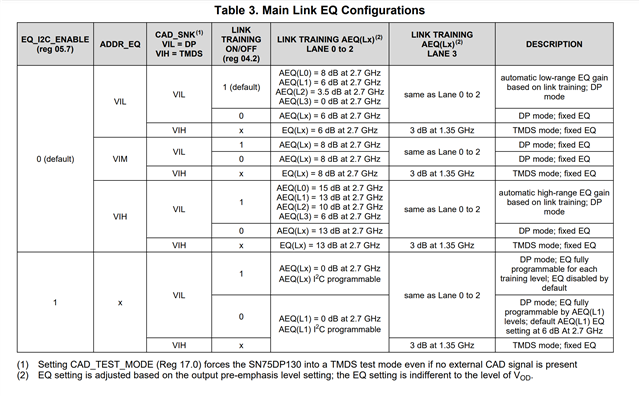

    I have another question on the Equalizer side (at the input from the source. How to tune the parameters? is it automatic from the DP130, or shall we tune and write into I2C reg?
    Renan
  • Renan
    Reference to Table 3 in the datasheet
    With EQ_I2C_ENABLE bit set to 1, they have two options of programmable EQ.
    David

    My question was more about how to identify that an EQ sets of parameters are optimum for my hardware. How to find the best setup.
    I could get an example from my IP vendor using also a DP130 on his card, and they give me the function that writes into DP130 I2C registers the values. Please find below the routine, and let me know your comments:

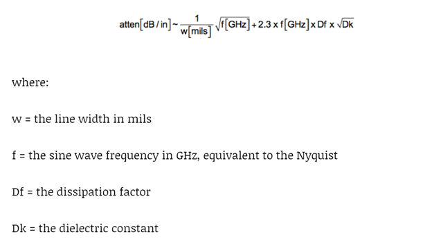

    Do they have a scope that measure the raw waveform or the eye diagram at the DP130 output? They can tune the DP130 EQ base on the signal quality of the raw waveform or the eye diagram.
    If not, then they can estimate the PCB trace loss between the DP source and DP130 using the formula below,
    So with 5.4Gbps data rate (2.7GHz Nyquist frequency), 5mil trace width, Df of 0.02, and Dk of 4.3),
    =SQRT(2.7)/5+2.3*2.7*0.02*SQRT(4.3) = 0.586dB/in
    Assume 6in trace, then the estimate PCB trace loss is 3.52dB.
    With estimate PCB trace loss of 3.52dB, you can set the DP130 EQ to roughly match up this value.
