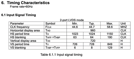

my customer tried to test SN65DSI84 on their own PCB, but they could not see nothing. (I2C communication is activated successfully but nothing happened after that.)
so could you give me some example codes to see just one color bar on LCD through the output?
here is the specification of LCD which my customer used.
also I want you to review the schematic of my customer. I will send you asap. Thanks,
Chase
Hi Chase,
For blank screen issues, there is an FAQ you can refer the customer to here: https://e2e.ti.com/support/interface-group/interface/f/interface-forum/852871/faq-sn65dsi84-no-display-output-with-sn65dsi83-sn65dsi84-sn65dsi85. Make sure to use the DSI Tuner to configure the device and make sure the initialization sequence is being followed.
The SN65DSI84’s output clock frequency range is 25 – 154 MHz. Since the display panel’s frequency requirement is within range of the SN65DSI84’s supported clock frequencies, this display panel can be supported.
You will need to make sure that your DSI CLK will be supported with your intended bpp and # DSI data lanes. For further details, refer to https://e2e.ti.com/support/interface-group/interface/f/interface-forum/945185/faq-sn65dsi84-sn65dsi83-sn65dsi84-and-sn65dsi85-resolution-guide.
