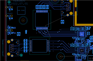

    PCB layout
  • Hi Lance,
    An Ethernet packet is a maximum of 1530 bytes in length, I am confused how the number 65500 applies here. Please send me an exact screenshot of how you are configuring this packet length, and how you are measuring "communication packet loss".
    Sometimes we see an affect of interpacket gap (IPG) on data transmission. What IPG are you using? Does adjusting the packet size change the IPG at all as well?
    Another thing, 30 and 100cm cables are very short. Please try using a 10m cable and see if that makes a difference.
    David

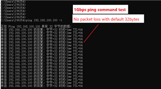

  • Hi David,
    I think the package lost issue causes ping/Web/SSH communication failure, I don`t konw whether the local FAE had carefully reviewed the schematic SCH and PCB design,can you check them again,thanks!Could you tell me which register you want to check ?
    below are the screenshots of ping command test:
    1. 1Gpbs test with 32bytes package size(no package lost)
    2. 1Gbps test with 1500bytes package size(more than 50% package lost)
    3. 100Mbps test with 1500 package size(no package lost)

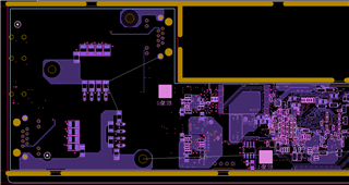

  • Hi Lance,
    To gain further confidence, can you read back registers 0x225, 0x265, 0x2A5, 0x2E5. These registers give us an indication of link quality.
    Further, we can have a look at your layout if you would like to share it.
    David
  • Hi David,
    Please help to check the follow register values, the three register value alway changed when I keep reading them during ping command fail, if this happened the ping command always fail even if with default 32 bytes package size, only reconnect the cable to recovere it.
    By the way, I will send the layout tomorrow:
