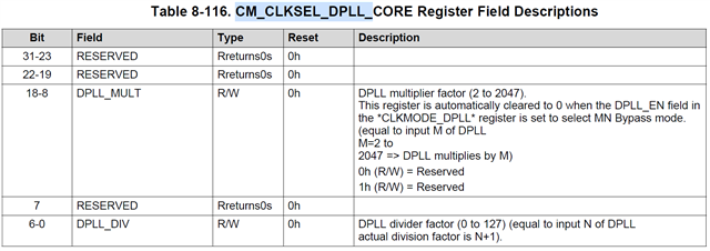

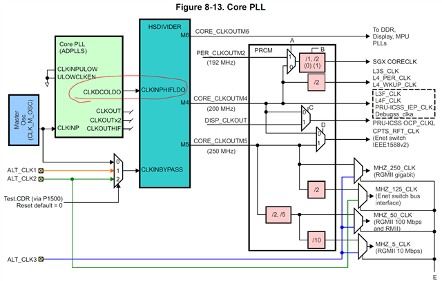

    Customer made modification on core PLL setting  CM_CLKSEL_DPLL from 0x3E817 to 0x3E9170x3EC17, change M from 1000 to 1001-1004, the RGMII clock should adjust to 125.125 to 125.5MHz. now no package drop.
    Does it make sense?
