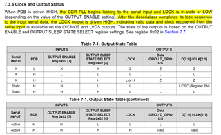

    If you aren't getting lock on the Des (948) side. Please see 948 datasheet below. It highlights the different states at which Lock is low vs. high.

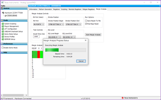

  • In addition, can you run MAP tool on the passing Vs. Failing system to analyze your link margin?
    Map tool can be operated from ALP software from the 948 side.
    Click on Margin Analysis tab on ALP software.
    select RX Port0 and select strobe settings 0 to 9
    Select EQ levels 0 to 14
    Dwell time 1000
    Start Margin analysis.
    Can you send me the results for a good vs. bad system?
    Fadi A.

    1)A+C:a lot number of back channel CRC errors can be read form the 0x0A/0x0B registers of 947, 948's lock pin is high level, touch panel can not work.
    If Lock is high that means valid data and clock are recovered from the serial input of the 948 and it is available on the LVCMOS and LVDS outputs, so no issue on FPD-Link Ser/Des ICs link.

    My colleague will try to use the MAP Tool for debug.

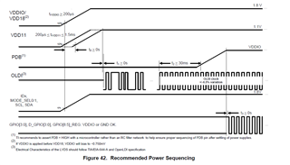

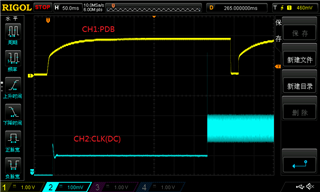

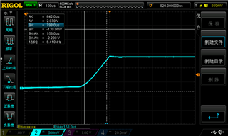

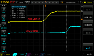

  • Hi Fadi,
    This is the power sequencing of 947, is it OK?

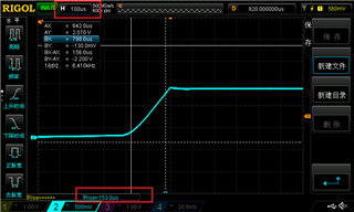

  • Hey Yao,
    Can you please capture VDDIO/VDD18/VDD11/PDB in a single scope shot?
    can you also measure the rise time of each VDD ?
    Are you following the recommended power up sequence init code?
    The schematic is encrypted, I will try to decrypt it if my boss agree.
    If you can't share, please make sure you have the correct configuration on the following:
    • Correct coax/STP mode strapped on both sides Ser/Des
    • Correct AC coupling caps for the cable mode
    • Does this application use PoC?
    Fadi A.

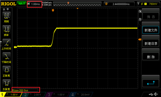

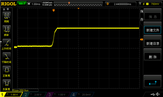

  • Hi Fadi,
    Sorry for delay, VDDIO and VDD18 is the same network:
    This is the VDD11,the rise time is almost 153us-200us:
    This is the VDD18(VDDIO), the rise time is almost 350us:

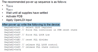

    And this is the recommended power up sequence init code:
    int reg_data;
    reg_data = ds90ub947_read_reg(ds90ub947->client, 0x03);
    reg_data = reg_data | 0x08;
    ds90ub947_write_reg(ds90ub947->client, 0x03, reg_data);
    ds90ub947_write_reg(ds90ub947->client, 0x4F, 0x80);
    ds90ub947_write_reg(ds90ub947->client, 0x07, 0x34);
    ds90ub947_write_reg(ds90ub947->client, 0x08, 0x34);
    ds90ub947_write_reg(ds90ub947->client, 0xC6, 0x21);
    ds90ub947_write_reg(ds90ub947->client, 0x1E, 0x04);
    ds90ub947_write_reg(ds90ub947->client, 0x0D, 0x03);//GPIO0
    ds90ub947_write_reg(ds90ub947->client, 0x0E, 0x33);
    ds90ub947_write_reg(ds90ub947->client, 0x0F, 0x03);
    ds90ub947_write_reg2(ds90ub947->client, 0x0D, 0x05);//DGPIO0
    ds90ub947_write_reg(ds90ub947->client, 0x40, 0x10);
    ds90ub947_write_reg(ds90ub947->client, 0x41, 0x4a);
    ds90ub947_write_reg(ds90ub947->client, 0x42, 0x3f);
    ds90ub947_write_reg(ds90ub947->client, 0x41, 0x4b);
    ds90ub947_write_reg(ds90ub947->client, 0x42, 0x88);
    ds90ub947_write_reg(ds90ub947->client, 0x41, 0x49);
    ds90ub947_write_reg(ds90ub947->client, 0x42, 0x10);
    msleep(10);
    ds90ub947_write_reg(ds90ub947->client, 0x42, 0x00);
    ds90ub947_write_reg(ds90ub947->client, 0x40, 0x14);
    msleep(15);
    msleep(10);
    ds90ub947_write_reg(ds90ub947->client, 0x42, 0x16);
    ds90ub947_write_reg(ds90ub947->client, 0x41, 0x47);
    ds90ub947_write_reg(ds90ub947->client, 0x42, 0x20);
    ds90ub947_write_reg(ds90ub947->client, 0x42, 0xA0);
    msleep(5);
    msleep(5);
    msleep(5);
