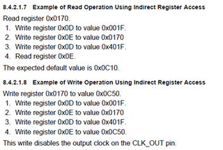

I am configuring the DP83867E PHY and am testing out read/write indirect register access to an extended register. I followed the 8.4.2.7.1 steps in the DP83867E datasheet, and after step 4, I am only reading 0x0170h instead of 0x0C10h. I'm not sure what I am doing wrong. I do have REGCR as address 0x000Dh and ADDAR as 0x000Eh.
Any help would be appreciated - thanks!

    For extended registers, it doesn't seem to work and seems to read the offset address instead of the data.

    This does seem odd. I confirmed that this sequence is valid using our DP83TC812EVM which has DP83867 on board, and got the following results:
    Are you using our DP83867 EVM? If so, would it be possible to have an MSP430 connected to MDC/MDIO to replicate this on our USB2MDIO software?
