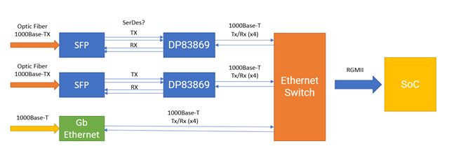

  • Hi Gerome,
    Please see below for our customer response:
    "Thank you very much for your response.
    Maybe I need to explain my design better. In my project, I am going to install a SFP for Optical fibre. I would like to transform the signal from this SFP (I assume it is SerDes) to 1000Base-T, in order to connect this 1000Base-T to a Ethernet switch (since my project is going to include SFP and Ethernet connectors). Please, see the attached picture "Schema.jpg".
    So, according to that, how I need to set the OPMODE bits (Table 60)?
    Also, if I use DP83869, I would need to use a MAC to send data to the DP83869 in order to configure the registers, am I right? Is there no option to configure the DP83869 without a microcontroller/FPGA/Soc? I am asking this because I would like to use DP83869 simply as a bridge without communication with the SoC in my board.
    Maybe you have another model which fits better with my application.
    Please, if you have any doubt, do not hesitate to ask me."
    I hope you can help us further. Thank you.
    Gerald
    For this configuration (Fiber to Copper), please ensure Reg 0x6E[11:9] = 0x4.
    You may use bootstraps to configure if there is not other requirement to check/modify registers.
    Sincerely,
    Gerome

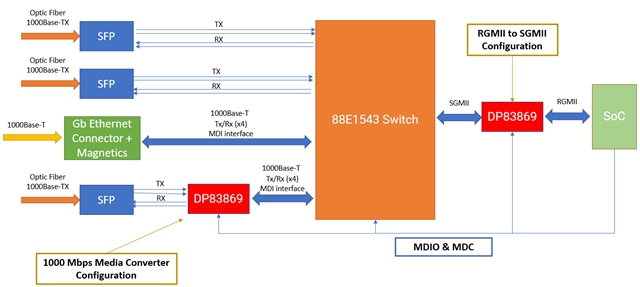

  • Hi Gerome,
    Thank you very much for your answer.
    Our customer thinks he is going to use the next configuration (see attached picture Schema_v2.png), but have some doubts:
    Below are his concerns:
    - Do you think is this the correct configuration?
    - In the DP83869 with 1000Mbps Media converter configuration, would I need magnetic transformers between the DP83869 and the Switch or they are included in the DP83869?
    - In the DP83869 RGMII to SGMII configuration, I assume this communication is bidirectional from Switch to SoC and viceversa, right?
    - I need to configure the Switch and the two DP83869 devices. Could I use the MDIO and MDC lines configuring different PHY addresses using the bootstraps without any problem?
    Thank you very much in advance.
    Gerald
    In media converter mode, please include transformers on DP83869's MDI connection. Please see datasheet for required parameters and connection diagram for DP83869.
    In SGMII/RGMII bridge mode, communication is bi-directional.
    To program multiple devices, having different PHY addresses using bootstraps would be the correct implementation.
    Sincerely,
    Gerome
