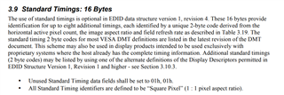

    On the EDID standard file you provided (thank you for this), I dont understand why multiple timing standards are necessary for my TFT to work properly. This is the data stored from adress 26h to 35h. I have provided data for standard timing 1 and i am confused about the rest of the timing standards. Am i able to leave these as 0x0100 or do i need to provide another value, and if so what value should it be?
    Additionally i have provided some of the first of the 18 byte descriptors (address 36h to 7Dh), i am waiting the manufacturer of the TFT to provide the rest of the information since its not in the datasheet. However when the first 18-Byte Data Block 'Preffered timing Mode' is filled in, what should be put into the remaining 3 18-Byte blocks? Is the solution to leave these empty and put the value 0x00 at address 7Eh to symbolise there is only one block of timing data?

  • Kacper, Gerald
    These questions are outside of TFP401A so I would refer to the EDID spec, in particular section 3.9
