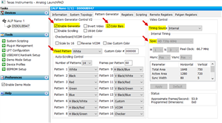

    • On the "suspect" units have you tried running internal patgen testing from 947 to see if any issue still present on the display? This method is good for isolation

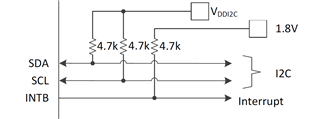

    INTB and SDA/SCL require pull up resistors

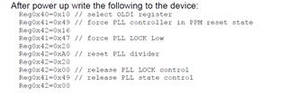

    Important - please confirm you are writing this code to 947 after power-supply/PDB is stable and after you apply OLDI input?
    Internal Patgen testing using Analog LaunchPad software for TI
    You can choose timing source as internal or internal with external timing or you can do all external - It's recommended to check all 3 modes and report the results back and choose spec resolution or can use custom resolution then enable generator and you can either choose fixed pattern or can choose color bars
