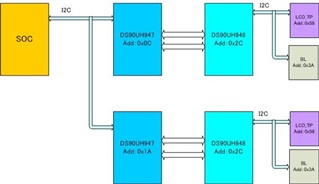

DS90UH947-Q1: According to the block , whether there will be a conflict with the I2C configuration 948
Part Number: DS90UH947-Q1
Hi,TI
The address of 948 is the same,will there be a conflict by configuring the 948 through the same I2C?
The slave devices can configure slave ID and slave alias to avoid conflict issues.
The configuration of the 948 conflicts which registers of the configuration 947 to avoid?
