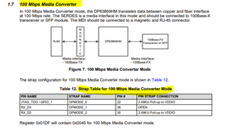

FYI, I'm using DP83869HM IC for 100base-TX 100base-FX in 100Mbs media convertor.
Note:
Op mode setting is 100Mbs media convertor setting, below are the setting image
Issue:
I checked the Op mode setting everything as per above image resistor setting, I did. I am using USB-2-MDIO Software Tool, I checked register 0x01DF it is showing 0041 but I checked in datasheet register value in 0041 that 1 means RGMII to 1000base-x is changed. How to I changed 0x0045 with any software reset is there? Please response ASAP.
