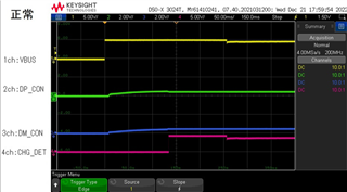

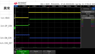

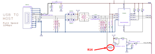

For below schematic, sometimes detect SDP and not detect CDP.
("Sometimes" is random)
Please let me know two points question below;
・If there any reason or improve point for detect DCP.
・I think that the reason for detection error is unexpected judge during 600ms by D+ start to detect prior to D- detect.
    In this case D- could not detect normally and bq24392 could not detect DCP, is this thinking correct?
Schematic is attached below;

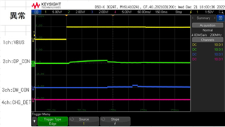

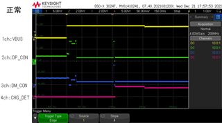

Waveform is attached below, NG pattern tend to the condition of power ON and OFF.
①PWR OFF
・OK
・NG (Not detect DCP)
②PWR ON
・OK
・NG (Not detect DCP and DP_CON=H / DM_CONJ=L)
・When set to invalid PULLUP_ENB (removed R14), bq24392 could detect DCP (normal operation).
・When R14 pullup change to host side, bq24392 could not detect CDP.
