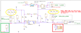

Dear Team,
Below is my schematic for PC9306.The high side is connected to 5V and it is going to an Arduino Nano.
SDA from our ASIC is coming to J113(SMA Connector Marked in RED) .The voltage at this side is 2.9V.
I removed all the pull ups connected to SDA.
5V side is R3,R4,R5 and low voltage side is R6,R7,R8.
What I onserved is even after removing the pull ups from both side the lower side am observing a voltage of 2.9V at SD1.(Low voltage side).
May I know why.
