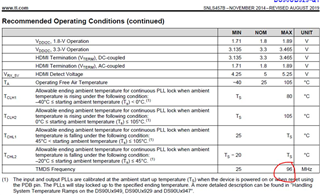

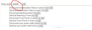

2. In our design, the input HDMI clock is around 95Mhz with the below EDID configuration,  which is quite close to the Serializer UB929’s maxim 96Mhz HDMI clock support capability, could you please help check any risk to run 95Mhz HDMI clock for UB929 part? Is there any margin of the 96Mhz for UB929?
    If HDMI does not drift and is stable at ~95MHz, this is okay.

  • Dear Logan,
    This black screen is very critical, Customer confirmed 441 times cluster black screen cases was reported by end user from January 2023  till now,
    We tried with the updated 929/948 init sequence revorted(return back to origianl flickering issue init sequence) , the black screen issue can NOT been reproduced from last Monday till now.
    Looks that the updated 929 and 948 intiializaiton is the cause of the black screen issue.  Can you please help check why the recommanded init sequence could case black screen issue?  waht is the gap?  Please  let us know if you need any more infomation to indentify the gap.
    James
  • Hi James,
    Can you provide the actual initialization scripts as well, since what is attached is the register dumps.
    Just to confirm I understand, you are saying the old version of the script also had flickering screen issues; but new version has full black screen?
    questiosn 3. we understand the UB948 locks to UB929 dpends on the HDMI singal quality. The question is aobut Cable Link detect, to detect if the cable is exist between 929 and 948 also depends on HDMI signal?
    Why is Cable Link focus here? If flicker/black screen, it is more important to verify Lock signal on DES side; since cable link will also drop with Lock loss.
    Has more investigation done on whether this is replicable with PatGen and internal timing from 929? This might help identify an HDMI issue.
    Has MAP tool or BIST been ran on link to quantify link margin and robustness of design?
    Logan
  • Hi James, +Ethan/Dongbao on CC
    At this point, it is very important to quantify the link integrity of the link by using MAP tool, BIST BER measurements, etc. MAP tool will create a table based on success at different AEQ values and strobe locations, which is used to determine the overall link margin of the design.
    The previous script provided will only implement any errata or required script sequencing, if there is an underlying issue with the design such as the below items:
    • Channel specification (return loss, insertion loss, cross talk, etc violations)
    • HDMI CLK input stability and jitter specifications
    • Power supply stability and noise specifications
    • Power sequencing issues
    All could lead to lock and link margin issues that manifest as flickering and black screen. AEQ value adjustment is not a valid workaround for failing channel specs or datasheet spec violations.
    Please work with Ethan on providing the following items:
    • MAP tool result measured from deserializer within ALP. See userguide here: https://www.ti.com/lit/ug/snlu243/snlu243.pdf
    • Measure total channel return and insertion loss and check against channel specification (Ethan can provide offline)
    • Measure HDMI CLK jitter and clock stability meets datasheet specification
      • This requires special scope settings to match CDR PLL, see below:
      • To characterize total jitter, TI recommends to measure the TJ@BER with a high speed oscilloscope equipped with a jitter analysis program such as DPOJET. The clock recovery settings used in the DPOJET measurement are designed to match the input PLL characteristic of the serializer device. For 949:
        - Method = PLL Custom BW
        - PLL Type = Type II
        - Loop BW = 1MHz
        - Damping = 700m
        - Target BER = 1e-10
        - High pass filter: None
        - Low pass filter: None
    • Provide schematic, layout, and information on cable length, etc
    • Try do to SER PatGen with internal timing to see if issue also occurs.
    Since there is such a high failure rate, I suspect we will find a system-level issue such as jitter, signal integrity, etc.
    Logan
