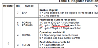

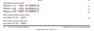

I am currently trying to implement the current measurement for the ONET1151L laser monitor diode.
The range I selected is 1540uA but the formula in the datasheet is confusing.
Should not be 1023 on the 10bit ADC equal to the maximum 1540 uA current?
Cheers
