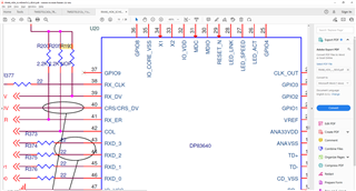

How can I change from MII to RMII in the TMDXRM46HDK board schematic?

Hi Chunho,
Both RMII and MII are supported by RM device. By default, the MII is used by HDK HW settings. To use RMII, the following modifications should be make on HDK:
1. Populate R193 resistor (2.2kohms) to pull RX_DV up
2. Replace Y3 with a 50-MHz oscillator
Refer below thread for more information,

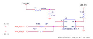

Dear Jagadish
Does it slave mode operating? How can i handle RMII_REFCLK (K19 pin of RM46L852)?
Should i have to populate R136 and do not insert R311?
Cho
Hi Cho,
No Need to do this modification according to old threads, you can keep them same and do only the two modifications i mentioned above.

Dear Jagadish
I'm confused.
You reviewed the following. I think that population of R136 and doing not insert R311 are right from your schematic review
And please recheck again below thread review is right or wrong

Dear jagadish
Thanks for your reply.
Yes, this modification also should need to be done.
-> What does it mean? You mean that i should have to populate R136 and do not insert R311 for RMII on HDK.
Cho
HI Chunho,
Sorry for apologies, i am on vacation for last week.
Yes, you are right.
