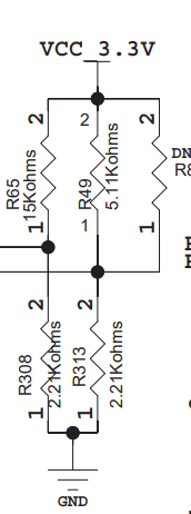

Ethernet design at 100M Base-T,6 pruduct samples put in the temperature chamber for testing. Say them as #1,#2,#3,#4,#5,#6.
Step 1. At +25℃,  Ethernet port could operate normally for  all 6 samples.
Step 2. At -20℃,  #3 ethernet port could operate normally.
             #1,#2,#4,#5,#6 ethernet port can't communicate with computer. with yellow LED on constantly, and green LED quick flashing
Step 3. Interchage the chip DP83822IRHBR from #3 and #4.
Step 4. At +25℃, Ethernet port could operate normally for  #3 and #4.
Step 5. At -20℃,  #4 ethernet port could operate normally.
             #3 ethernet port can't communicate with computer. with yellow LED on constantly, and green LED quick flashing
Question: If the chip have any concern in low ambient temperature?
                Attached is my schematic
2437.ECG12S1-PHY_20230206v2.pdf

    • I see that from your schematic, Ribas is not exactly 4.87k ohms with 1% tolerance. This is critical for the temperature sensitivity

    I double check on your schematic, I do see some of your register is not following datasheet requirement:
    Are you able to change the resistor to see rather it help with the PHY at -20 degree Celsius? The strap level or voltage level will get effected by the temperature.

    I think you know the config of strap level,  see attached file.
    RX_DV(pin26) is set to mode 3
    CRS_DV(pin27) is set to mode 2

    Sorry for the confusion. You are correct on the strap voltage level. Just want to conclude the finding we have so far.
    • There is one abnormal chip where it goes from RMII mode to RGMII mode when temperature goes to -20 degree Celsius.
    • There is another one abnormal chip goes from MDIX to MDI when temperature goes to -20 degree Celsius
    From what my understanding is the strap pin for RX_ER and RX_DV somehow change the strapping voltage level at -20 degree where it disable RMII and enable RGMII, disable the auto MDIX feature so that the PHY cannot detect the Ethernet port orientation and not able to communicate. That is why I am concern on the strap voltage level during -20 degree Celsius. Again sorry for the confusion. Are you able to measure the strap voltage level of this two pins when temperature is -20 degree and 25 degree.
    Just want to confirm is the root cause is from these two strap pins.

    Disconnect the trace RX_ER from host chip to PHY chip. leave the RX_ER pin unconnnected. The board can work normally ar -20 and -40, as well as -45 degree. And register 0x0017 is always 0x65.
    Could you analyze what's the root casue?
    Can I leave the RX_ER pin unconnnected in our design ?
  • Hi Liang,
    It seems like the RX_ER is strap into wrong mode when it is connected to the host chip. In order to check the strap state. Reading 0x467 and 0x468 will be helpful to tell what mode is the PHY in during the under voltage.

    1. +25 degree Celsius: 0x0017=0x65, 0x0467=0xf6f,  0x0468=0x0
    2. -20 degree Celsius:  0x0017=249, 0x0467=0xe6f,  0x0468=0x0
    BTW, any concerns, if I leave RX_ER unconneted ?
  • Hi Liang,
    From the register 467, we can confirm that RX_ER are strapped incorrectly under low temperature. It seems like RX_ER pin are pulled low by the SoC that this pin is connected to in the lower temperature. Could you check SoC side rather it is there is pull down during the low temperature?
    Hillman Lin
  • Hi Liang,
    Hillman Lin
  • Hi Lin
    Disconnect the trace between SoC and Phy chip,. In PHY chip side, RX_ER high level is 3.3V (Both high or low temperature).
    It 's about 1.0V when the trace is connected  (Both high or low temperature)

    I would like a plot on SoC without RX_ER pin connection. I do think SoC is the main issue that is pulling RX_ER pin low for DP83822 during under voltage. Could you take a look rather this is the root cause for the DP83822 strap into wrong mode?
    Thank you,
    Hillman Lin
  • Hi Lin
    Certainly, the root cause is from the SoC. But could you analyze why ?
    1. It will be the wrong mode when RX_ER=1.0V (connected) at low temperature
    2. It will be the right mode when RX_ER=3.3V (unconnected) at low temperature
  • Hi Liang,
    During the strapping process, the PHY will read the voltage level of RX_ER pin to know what mode it need to operate in. However, SoC is pulling the strap voltage to 1V so that RX_ER will read the wrong voltage level and tell the PHY to work in different operational mode. I won't able to tell how does the SoC pull the RX_ER pin low during low temperature.
    There are two possible solution to solve this problem:
    • Make sure SoC is providing 3.3V to RX_ER during the strapping process
    • Configure the PHY to right mode using the register within the PHY after the power up process
    Hillman Lin

    SoC is pulling RX_ER strap voltage to 1V. It's always 1V both +25 and -20 Degree.
    But PHY chip go to a wrong mode only at -20 Degree. PHY strap is more sensitive at low temperature, am I right ?
    It can't work if Configure register 0x0017=0x65 only, after power up process.
    Could I need to configure register 0x0017 and 0x467 back to the right value? Or any more register I need to check and configure?
  • Hi Liang,
    Yes you are correct, the strap pin for PHY are more sensitive in lower temperature.
    I would like one more clarification on your setup. What kind of MAC interface are you trying to perform? If your PHY is acting as RMII master, could you measure the clock speed in RX_D3 and CLK_OUT pin?
    If possible could you also make register 0x0009 bit[5] = 1?
