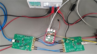

I have a measurement setup with two DP83867ERGZ-S-EVM and want to connect the two boards back-to-back via SGMII.
The two boards can establish a connection but when running an iperf3 measurement or a netAlly LANBERT measurement I can see packet errors of about 0.01%.

I see IDLE_ERRORS on one device in register 0x0a. Furthermore I see some pending interrupts in register 0x13, but they change over time.
Register 0x15 shows a growing amount of RX_ER on one device.
I saw in related questions that SGMII autoneg should be disabled, so I updated register 0x14 from 0x29c7to 0x2947 and soft reset the device afterwards (0x4000 into 0x1f).
With this setting I still see the packet errors on one side.
Is there anything I forgot?
