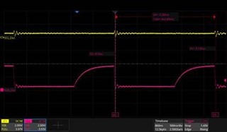

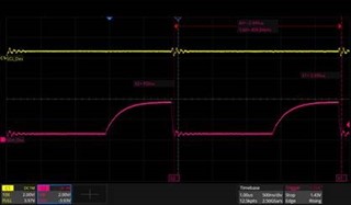

    1. The unit base for 928 to generate I2C master CLK is 20ns?
    2. But why I verify customer's setting, the CLK rate is 606Khz?
    3. What is the tolerance spec of this internal oscillator(20Mhz?)? Whether the clock difference in 2 system that customer is facing is reasonable?
    System-A: 928 I2C rate: 442.48kHz
    System-B: 928 I2C rate: 409.84kHz
    Alex

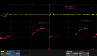

    Btw, Customer engineer told me they're facing a strange problem on 928. They set 0x26 = 0x19, 0x27 = 0x19, but found the I2C clock rate is not 400kHz. But after they set it to 0x26 = 0x0b, 0x27 = 0x16, the I2C clock became around 400k. But they face another problem like I mentioned in above. With same register setting, project A got 442Khz, and project B got 409kHz.
    Alex
  • Hi Alex,
    This is expected behavior. The rate of I2C is based on the internal always on clock and the register programmed value. The always on clock has inaccuracy up to 10+% across PVT, this translates to slight mismatch between programmed and measure value.
    Logan
  • Hi Logan,
    Thanks for the explanation. So we can expect max 10% variation of SCL clock rate across different system.
    But it still can't explain the other problem that customer is facing. When set 0x26 = 0x19, 0x27 = 0x19, they measured the 928 I2C clock rate is not 400kHz. So they manually adjust the setting to 0x26 = 0x0b, 0x27 = 0x16, the I2C clock became around 400k. If so, the base unit would be around 70ns instead of 50ns. Why?
