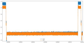

We are using PatGen mode of ds90ub960 to generate (1280*720, RAW8) fake data to CSI-2 port 0 and  NVIDIA Orin was used to read the CSI-2 data.
We have probed the CSI0_D3P and CSI0_D3N pins but both the voltage level range and waveform are odd.
Figures below shows the waveform from Oscilloscope:
Question:
1) We noticed the signal voltage level is range from 0-500mV during HS transmit. That is not the typical value(200mV) and even over the MAX(250mV) range which recommended in the MIPI D-PHY handbook. Will the output voltage can be a problem for Orin to read the data?
2) The voltage level of the signal in HS mode is not fixed, which is changed from 150mV to 500mv(From the figure, it includes several completely different waveforms in HS mode). Is it normal?  If normal, does each segment of the waveform represent a different meaning?

  • Thanks for your reply, the details are given below:
    - Test Setup:
    (Refer to 'Analog LaunchPAD v1.57.0010\PreDefScripts\DS90UB954\954_CSI_patgen_RAW8_1920x1080p30.py' )

    - Measuring:
    Oscilloscope: Keysight DSV334A Oscilloscope
    Probe: Keysight N5449A adapter + N2873A probe(10:1)
    Figure: Y-axis voltage / v, X-axis time / s
    Probed pin: D3N: blue line, D3P: orange line
  • Hi Guo,
    The data lanes need to be connected to a termination in order to properly measure the HS burst sequence. Are the pins connected to the NVIDIA Orin or a termination board?
    Cindy
  • Yes, the pins are connected to the NVIDIA Orin.

  • Hi Cindy,
    I'm Guo's colleague.
    Our Orin uses D-PHY mode.
    For the waveform above, we are wondering if it is reasonable that the signal seems to have different high and low levels in different areas?
    Thanks a lot,
    Lee
  • Hi Lee,
    The measurement does not look as expected. The high speed burst between the LP states should not have such varying voltage swing, and the voltage should also not exceed the MIPI specification. I would try measuring this directly on a scope with a termination or check the test setup/connections.
    Cindy

  • Hi Cindy,
    Sorry for the late response,
    1. We checked the output signal again, the data lane waveform still looks the same. But in the clock lane, a voltage of 0.5V lasts for about 50ns, occurred at LP11-LP01-LP00 switching both in CLKN and CLKP. Also, the clock does not seem to toggle during HS. We are all confused about this problem.
    2. As the configurations in the PatGen script, the output frame has been set to 1280*720 30FPS and the data rate is 400Mbps. As MIPI CSI2 specification, each faram should contain 720 long packets and each packet should send 1280byte. So to sepak, the time taken to transmit each long packet per lane should be approximately ((32bit(header) + 1280*8bit + 16bit(footer)) * UI) / 4lane = 6430ns. But our long packet transmission only takes about 4200ns.
    Could you please give me some ideas on the problems I mentioned above?

    Thank you for your information.
    I post the waveform below for the first point in my last reply:

  • Hi Cindy,
    Thank you for your kind words!
    1.
    SOC reporting any errors in receiving the data
    We read the video stream from V4L2 and the errors were caused by D-PHY. We decode the error status code with the tool "nvcapture-status-decoder", the output is shown below:
    NVIDIA camera capture status decoder utility (Version 2.00)
    Copyright (C) 2019-2020, NVIDIA Corporation. All rights reserved.
    Class: Global
    Type: PHY_Interrupt0
    PHY: 0
    CIL: 0
    Stream: 0
    VC: 0
    Status: 136
    Timestamp: 2470133328
    PHY_Interrupt0 : 0x0000000000000088
        -cil_data_lane_ctrl_err0     [ 3]: 1
            LP sequence error detected on data lane [A/B]0
        -cil_data_lane_ctrl_err1     [ 7]: 1

  • Hi Lee,
    Thank you for the additional information.
    Could you please explain in more detail what the settings are indicating?
    This would include making sure the receiver CSI-2 settings are configured to match what you programmed in the deserializer (number of data lanes, data rate, continuous or non-continuous clock). I would contact NVIDIA directly about configuring this if you have more questions.
    Are you using a custom designed UB960 board? If so, you may want to double check it is not a layout issue with the CSI-2 traces (TI can help you review this if you submit another E2E requesting it). You can try testing with a 960 EVM if you have one to rule out a layout issue.
    I suggest reaching out to NVIDIA about the LP sequence errors. Given that 1) the other 960 board is causing this error as well and 2) you are configuring patgen + CSI-2 forwarding following the Patgen section of the datasheet, it may be software related on the receiving side since your SERDES config is all correct. You can send your full 960 script to me if you want me to double check your CSI-2 settings since the last one you sent does not include the speed configuration.
    Cindy
