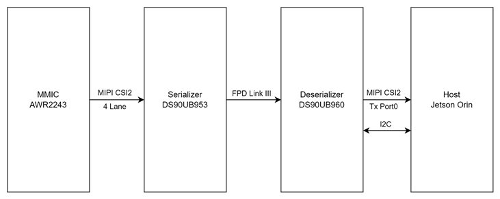

We are using DS90UB953-Q1 and DS90UB960-Q1 as SerDes to transmit the video stream from a sensor with MIPI CSI-2 interface. We only connect one sensor and set the strean output to DS90UB960 CSI2 port0.
However, we cannot read the video stream from the termination side and we got “LP sequence Error” from termination's D-PHY.

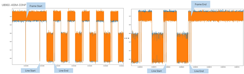

We probed the waveform on the lanes between the sensor and Orin, we found that the time specifications in the long and short packets of CSI-2 are consistent with the requirements in the CSI2 manual. However, compared to the CSI2 waveform sent by the sensor, the timing of the frame and line sync packets from 960 CSI2 output port appears to have shifted.
The frame end packet did not appear at the end of the frame data transmission, but appear at the place where very close to the start of the next frame. And the line start/end packet also seems strange.
There is always a long LP status hold after the line start packet is sent, before the line data. However, the line end packet will appear as soon as the line data has finished.
The sync packets in the waveform of the sensor CSI2 output port are correct, but become strange after SerDes in the DS90UB960 output, which confused us.
I think something must have gone wrong when processing the SerDes, however we haven't found any errors according to the registers both in SerDes.
Could you please give us an idea of how to overcome the above problem?

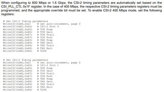

  • Hi Lee,
    1. In 960 Reg 0x1F, can you try setting bit[2] REF_CLK_MODE back to the default value of 0?
    2. Just to confirm, do the CSI-2 settings on the 953 match what is coming from the imager? And do the CSI-2 settings on the 960 match what the SOC is expecting? I noticed that 960 is configured for non-continuous clock while 953 is configured for continuous clock, so I want to double check that this is the correct configuration.
    3. Can you try turning off the imager and use 953 patgen instead?
    Cindy

    I also post the device layout map here, which may be useful.
    Thanks a lot.

  • Hi Lee,
    I reviewed the register dump and patgen script that was shared earlier.
    I found an error in the following snippet:
    TRY(err, regmap_write(map, 0xB2, 0x02)); // PGEN_ACT_LPF1 0x438=1080
    TRY(err, regmap_write(map, 0xB2, 0x00)); // PGEN_ACT_LPF0
    TRY(err, regmap_write(map, 0xB2, 0x02)); // PGEN_TOT_LPF1 0x465=1125 0x200=512
    TRY(err, regmap_write(map, 0xB2, 0x00)); // PGEN_TOT_LPF0
    When setting the total lines per frame, the vertical blanking (vertical front porch, vertical back porch, and vertical sync) must be added to the total lines per frame. In this case the active lines per frame and totals are the same. However, later on the vertical front porch and back porch are 12 each. PGEN_TOT_LPF0 should then be a minimum of 0x14. Would you be able to change these values and retest?
    Additionally, in the 960 register dump, 0xA5 which measures the REFCLK frequency in MHz reads as 0x1d (29 MHz). Can you confirm an oscillator with 25Mhz frequency is being used?
    Zoe
  • Lee,
    I think what you are seeing is actually expected behavior. Let me try to explain:
    Architecturally, the 960 uses a line buffer inside for the received CSI-2 data. The 960 will wait until it has received one complete short or long CSI-2 packet before forwarding the packet through the CSI-2 output. In the scope shots you can see this happening:
    In general, CSI-2 as a protocol does not require discrete DPI timing for horizontal timing signals which is why architecturally this is allowed. If you actually want to get discrete line start/line end timing in your application (which it seems like is your goal from the usage of line start/line end packets). You would need to increase the CSI-2 speed of the 960 >> than the CSI-2 speed of the sensor. That way the effect of the 960 having to wait to buffer a video line would be minimized. Even then it may not be possible depending on your horizontal blanking timing from the sensor. There would need to be enough time in the horizontal front porch of the video signal for the 960 to send an entire video line out and be ready to forward the line end packet. The 960 has a maximum transmitter speed of 1.6Gbps/lane so you would need to calculate how long it takes to send one video line at 1.6Gbps/lane and compare that against the horizontal front porch time in us to see which is smaller.

    Hi Casey, thanks for your kind explanation. We were also wondering if the voltage level is also expected during HS transmission?
    We probed it directly from the UB960 CSI output pin, it seems does not match the MIPI standard(150-250mV).
    As long as the voltage is as expected, we can be confident that all is well in the SerDes.
    Lee
  • Lee,
    Is the CSI-2 RX active and applying dynamic termination to the interface? The HSTX transmit voltages for DPHY rely on the sink providing termination during the HS portion of the packet so it looks to me like your CSI-2 RX may not be applying termination. Although the probe setup also seems odd because you appear to be getting voltages swinging below 0V too which is not real. You may also have a probing issue
    Casey
  • Hi Casey, you are right, we tried using another oscilloscope now there is no voltage below 0V while the HS voltage is still above the standard.
    Since some of the error messages were prompted by Jetson Orin, we think that the receiver is already activated.
    By these words, you mean that the voltages are dependent on the configurations in the receiver?
    We don't know what "applying dynamic termination to the interface" means, can you elaborate?
    Lee
  • Jim,
    MIPI CSI-2 D-PHY physical interface uses a dynamic termination scheme. You can study more about the physical interface here for example:
    https://download.tek.com/document/61W_25772_0_HR.pdf
    So during the HS portion of the waveform, the receiver (Orin) will terminate the signal 100 ohm differentially. If the receiver is not active, then the signals will show higher amplitude. First of all, please make sure that the Orin is set to DPHY mode instead of DPHY. You may also need to verify that the receiver is configured to receive data a 400Mbps/lane rate.
    Also make sure that in the 960 since you are using 400Mbps/lane that you program these extra settings from section 7.4.19 of the datasheet to ensure that the timing is correct:
    Casey

  • Hi Casey, thank you for the professional explain, we found the voltage did get normal when we run the script to read the stream on the NVIDIA Orin side.
    Lee
