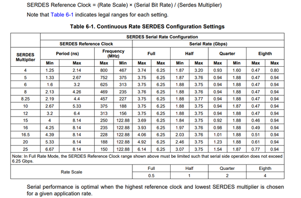

I am trying to configure TLK6002 in Half-rate mode.  I am following the below table to select reference clock and SERDES Multiplier.
I am configuring Serdes to work at 2.46 Gbps at HALF_RATE mode. Based on the formula provided below and sedres multiplier value from the table I have choosen  the following configuration.
1.SERIAL RATE : 2.46Gbps.
2. Serdes MULTIPLIERr: 20
3. TX_CLK= ( serdes_serial_rate/20 ) = 123Mhz;
4. from the below formula I got REF_CLK =123 Mhz;
When I program the above configuration I am getting Transmit Overflow and Underflow errors.
Is there any corrections to be made in Calculations ?
Note: I have programmed the 0x01 register to Half rate.

  • Hi Drew
    From the above attachment provided (Continuous rate SERDES configuration settings table ) it is given that for HALF RATE the RATE_SCALE should be taken as "1".
    I have taken RATE_SCALE value as "0.5" for HALF_RATE and did the SERDES REF_CLK calculation
    Eg: For 2.4576 Gbps I took  TX_CLK  as 122.88 Mhz
    From the above formula provides I took RATE_SCALE as " 0.5 " SERDES_MULTIPLIER as " 20 "  I got REF_CLK as 61.44Mhz.
    When I work with this configuration I have "ZERO" TX_UNDERFLOW and TX_OVERFLOW errors but still the 0x01 register is showing 0x10D( i.e Rate is not configured ) and even Channel Sync is happening.
    The register 0x05 value is 0x600B.
    But from the above table you can see for 2.4576 Gbps they have given REF_CLK as either 153.6 Mhz and 122.88 Mhz. while I have given 61.44Mhz
    Can you correlate this behavior
    Mallikarjuna
