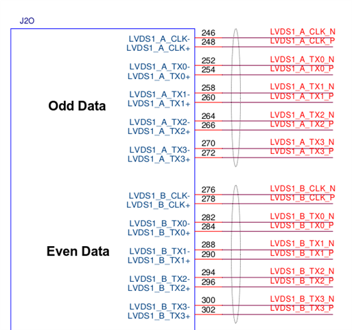

    The display feed coming out of the processor is Even and Odd LVDS data lines as shown in the image. Does separation of data is needed in this case if we use 2x DS90UB927Q-Q1 Serializer for Odd and Even LVDS data respectively?
  • Howdy!
    Just so that I can understand the situation more, what is this approach attempting to address? This sort of situation is usually avoided by utilizing a dual channel device, is there a specific reason that your system would need to use two single channel devices on either end?
