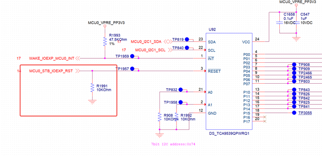

HI TI Expert,
as sch show below, during MCU standby mode, TCA9539 reset pin will be pull down, will the INT pin still action correctly when there is a tigger on input port ?
BR
Junsong_Gu
HI TI Expert,
BR
Junsong_Gu
Hey Junsong,
Clemens' is correct here. The /RESET pin is active low so a pullup resistor is required if the /RESET pin is not in active use. Let us know if you have any further questions.
