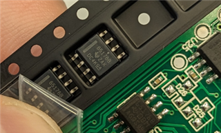

I think we have counterfeit pieces for next reasons:
- In some batches the current consumption of this chip is 17mA (no communication activated)
- In other batches, the current consumption is 1mA (no communication activated)
- I have done different methods to confirm these last two affirmations.
- Both chips are working "fine", or at least, it seems they do. They are communicating well in short distances.
- Issue: This different current consumption is causing fault in our test equipment in factory due to the behavior is different from the original chip, 17mA of current consumption is our specification in the test equipment. So currently it's a very critical point to solve.
- I attach some pictures of good and bad samples.
- Could you confirm if these lot codes are according to Texas Instruments? Thanks in advance.
Good ones serigraphy:
Sample 1:
First raw = 65176B
Second raw = 75M
Third raw = A92VG4
Sample 2:
First raw = 65176B
Second raw = 88M
Third raw = A031G4
Bad ones serigraphy:
Sample 1:
First raw = 65176B
Second raw = 2AK
Third raw = DC4KG4
Sample 2:
First raw = 65176B
Second raw = 29K
Third raw = C7HVG4
  • Hi Héctor,
    So in general lower than expected current with no functional failures isn't usually a super large concern - we don't spec a minimum unloaded device current.
    That being said:
    Good Sample 1: Legitimate Device
    Good Sample 2: Does not show up in our system under correct device* (potentially counterfeit - more info here:  https://www.ti.com/support-quality/quality-policies-procedures/anti-counterfeit.html )
    Bad Sample 1: Legitimate Device
    Bad Sample 2: Legitimate Device.
    So it does seem like you may have a counterfeit device - but its not the one you were concerned about - and I think I know what's going based on your results - potential counterfeit aside.
    1. There are two versions of this device that exist - your good sample 1 is older material - the original die of the device. The two suspect devices are using the newer version of the die.
    2. Since when we released the new die a couple years ago there are multiple variants of the device that exist - with only one datasheet. So how the changes get implemented onto the datasheet really are going to reflect boundary conditions. I.e. the typical values may shift and not show in the datasheet as long as you can apply the same boundary conditions - i.e. max and min spec changes will always be reported - typical changes being reported is more variable as the typical value is already variable based on use case - so it is possible that the new die is less power intensive (which is a good thing - as tens of mA's with no load  is not great performance in general) but since its still bounded by the max condition of the datasheet that spec most likely didn't change.  So the both versions are bounded by the same limiting values - but typical performance can be different and in this case - it seems to be better.
    3. We don't spec a minimum supply current so from TI's perspective no failure has occurred and based on the history of this device the differences are more or less in line with what to expect.
    That being said - if you do find functional failures please don't hesitate to inform as there could be another issue.
