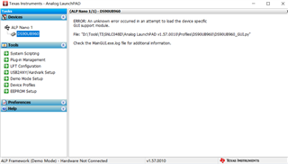

When i load profiles DS90UB960 to ALP, unknown error occur,how can i fix it?

After downloading ALP from ti.com (https://www.ti.com/tool/ALP), did you also run the ALP-PROFILE-UPDATE program?
Justin Phan
For setting up ALP on a computer, it should be as simple as downloading ALP setup executable from the TI website (https://www.ti.com/tool/ALP). Then, run the ALP-PROFILE-UPDATE setup software below that.

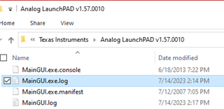

1) Was the default file path chosen when ALP was installed?
C:\Program Files (x86)\Texas Instruments\Analog LaunchPAD v1.57.0010
If you go to the file path "C:\Program Files (x86)\Texas Instruments\Analog LaunchPAD v1.57.0010" on your computer, there is a file called "MainGUI.exe.log".
2) Can you open it and share what error message was logged there?

There are a few ways we can approach this. You can either:
It is possible to install ALP somewhere besides the default installation path, but it's possible that the ALP-PROFILE-UPDATE software installed extra software based on the default installation path and not where you actually installed ALP.
