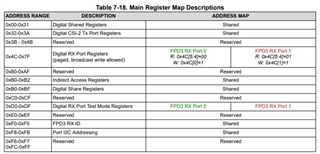

  • Hi Dhruv,
    Let's try making these changes to the script and see if we get desirable results.
    • If only port 0 is being used for your application let's set FPD3_PORT_SEL to 0x01. By setting FPD3_PORT_SEL to 0x01 you are enabling writes to port 0 registers and performing reads from port 0 registers. Originally, you had FPD3_PORT_SEL set to 0x11 which would be enabling writes to port 0 registers but performing reads from port 1 registers. On the 954 certain registers are port specific. For example, when you had FPD3_PORT_SEL set to 0x11 the RX_PORT_STS1 register was reading 0x40 indicating the receiver for port 1 is not locked. However, when you had FPD3_PORT_SEL set to 0x01 the RX_PORT_STS1 register was reading 0x13 indicating the receiver for port 0 is locked. The figure below shows registers 0x4C-0x7F and registers 0xD0-0xDF are port specific.
    • Try reconfiguring your TargetID register and TargetAlias register. These registers are necessary in order to be able to communicate with a remote sensor. For example, you set your SER_ID and SER_ALIAS in order to be able to communicate with your remote serializer.
    • Confirm your BCC_CONFIG bits [2:0] match your strap settings.
    • Lastly, I would keep the BCC_WATCHDOG enabled as this helps to prevent a lock-up condition on the control channel when no response is available from the remote/remote-slave device.
