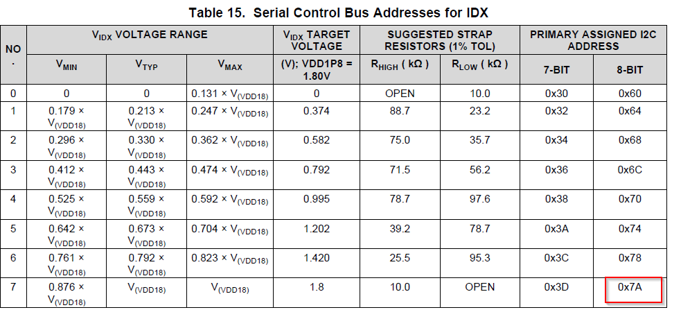

The I2C address of 954 is 0x7A(8bit), it is right.

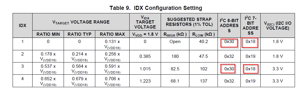

But, as for 953,
0x18 is 7 bit I2C address ,and 0x30 is 8bit I2C address.

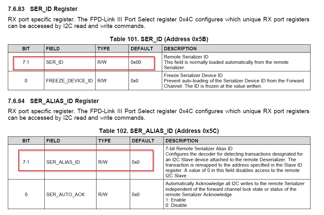

why SER_ID and SER_ALIAS_ID are set by 0x30 and 0x18 ?
According to SER_ID and SER_ALIAS_ID definition,  7:1 is I2C address, so , 8bit value (0x30)shall be set for both of SER_ID and SER_ALIAS_ID.

  • David,
    As explained in the 0x5c register description, the transaction to this alias address is remapped to the ID address. So alias is just an alternative address and it is very useful in cases where there are multiple sensor devices with the same id as explained in section 7.5.4 of the DS. You can keep alias and id the same if you don't have multiple devices.
