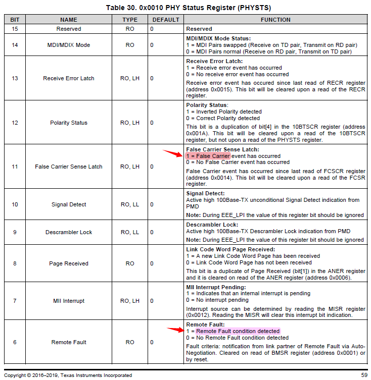

    We have an online debugging session today internally, there are 3 findings that may need your expertise to confirm. Thanks!
    1: After trying ping to PC & some phy register reading, we found out that bit 11 & bit 6 in 0x0010 become 1. I am not sure if this indicates any problems?

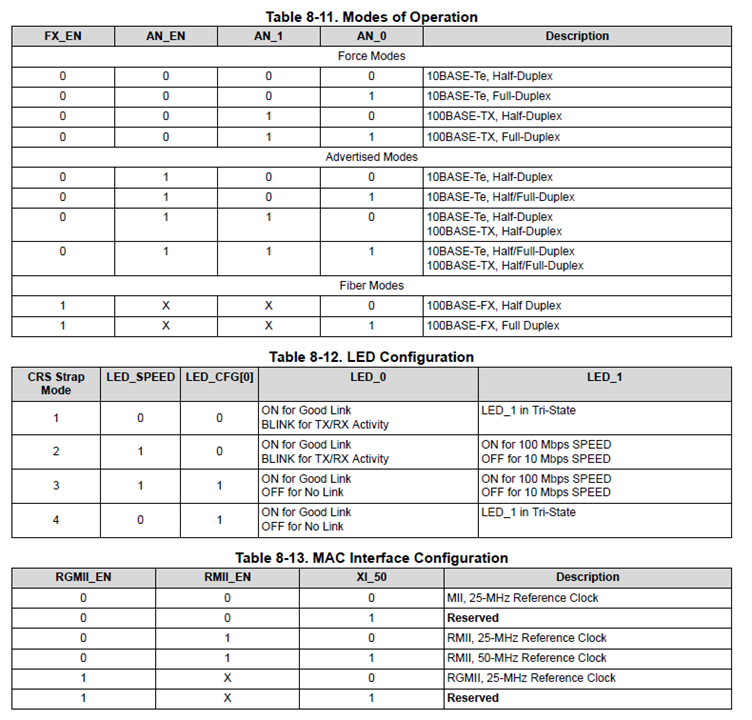

    2: Customer is configuring RMII master signaling, so using MAC interface configuration 010 below (25Mhz reference clock). They are also using the advertised mode. So may I know if RMII master signaling can work in advertised mode?
    The false carrier sense latch bit in register 0x10 is set to 1 whenever a false carrier event has occurred, which essentially means there was a packet error.
    The remote fault bits of the base page are used to transmit link fault and error information to the link partner
    Yes, RMII master should be able to advertise all required modes.
