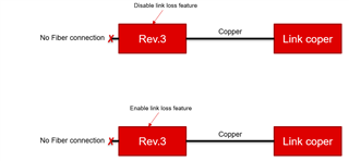

  • Hi Kaya,
    Sorry if that is confusing. Let move one step back, register 0x0001 is a link status on copper. Our goal for Rev.3 is having this register 0x0001 link status register to detect on both copper side and fiber side. However, some of the customer want this link status indication only detect the copper side. Therefore, we had register 0x01EC to play around with the fiber link (FO cable). But copper link should follow the normal link drop on and off pattern.
    0x01EC should not have an effect on the copper side. I will try out the experiment on my side as well.
    Hillman Lin

  • Hi Kaya,
    Sorry for the confusion. If possible, I would like to clarify what is the link status of the following scenario?
    Thank you,
    Hillman Lin
  • Hi Hillman,
    For the top scenario: Copper Link is Down (Copper Link LED is OFF). The copper link always follows the fiber link.
    For the bottom scenario: Copper Link is Up (Copper Link LED is ON). In this scenario, if we plug in and out the FO cable, the copper link is Down. After a SW Restart, the copper link is Up again for No Fiber connection.

    Revisions 0x01EC = 1FFC(Link Loss Enabled)
    0x01EC = 1FFD(Link Loss Disabled)
    REV.1 copper link drops after 8-10 seconds after power-on copper link does not drop after power-on
    REV.3 copper link does not drop after power-on copper link drops after 8-10 seconds after power-on
    The table above shows our observation, when no FO cable is inserted into Transceiver after the register configuration and SW Restart. Both Revision work inversely considering the Link Loss Pass Through Mechanism.
    To make Rev.3 works as Rev.1 (as given in Table above),
    • Link Loss Pass Through must be disabled or
    • FO cable must be plugged in/out
