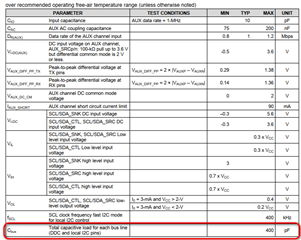

we new design HDMI 2.0 TX side used DP159 & TPD5S115YFFR solution.
Please help as follows:
1.please revuew circuit of attachment.
2.If the access circuit, we are worried that the DDC capacitor exceeds HDMI SPEC 50PF,Can you help me confirm this problem?(DP159 datasheet Cbus =400PF)
