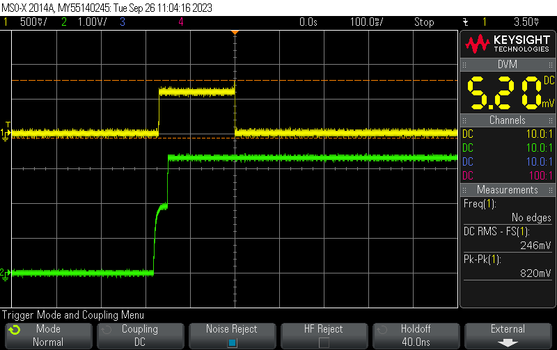

We encouter with problem in RGMII side
When we connect RX_DV line  to MAC side  (ZYNQ 7000) and power on the chip have no link
We disconnect the line and we have the link back
What can be the problem ?

  • Hi Hezi,

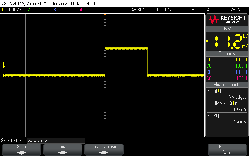

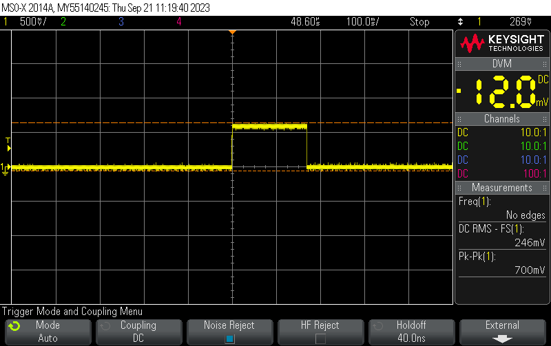

    My guess is that RX_DV is somehow driven high from the FPGA. Any stray voltage on RX_DV at power-up can latch the device into RMII mode and cause this issue.
    Can you please connect RX_DV and measure the waveform during the power-up or RESET_N toggle?
    Can you also read the following registers (0x00 to 0x1F, 0x0467, 0x0468) during the state when device is not linking up?

  • Hi Gokul,
    Thanks for your response
    RX_DV signal on Power on
    RX_DV signal on RESET_N toggle

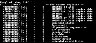

    When set the PHY to 100M   lost the link

    Register Dump:
    read reg 0x0=   0x3100
    read reg 0x1=   0x786D
    read reg 0x2=   0x2000
    read reg 0x3=   0xA240
    read reg 0x4=   0x1E1
    read reg 0x5=   0x21
    read reg 0x6=   0x4
    read reg 0x7=   0x2001
    read reg 0x8=   0x0
    read reg 0x9=   0x0
    read reg 0xA=   0x100
    read reg 0xB=   0x1000
    read reg 0xC=   0x0
    read reg 0xD=   0x401F
    read reg 0xE=   0xA240
    read reg 0xF=   0x0
    read reg 0x10=  0x4013
    read reg 0x11=  0x108
    read reg 0x12=  0x0
    read reg 0x13=  0x0
    read reg 0x14=  0x0
    read reg 0x15=  0x0
    read reg 0x16=  0x100
    read reg 0x17=  0x1E1
    read reg 0x18=  0x400
    read reg 0x19=  0x803F
    read reg 0x1A=  0x0
    read reg 0x1B=  0x7D
    read reg 0x1C=  0x5EE
    read reg 0x1D=  0x0
    read reg 0x1E=  0x2
    read reg 0x467= 0xFFF3
    read reg 0x468= 0xF

  • Hi Hezi,
    I see from the logs that all the straps are latched to Mode4. But in the schematic, I don't see any pull up resistors on RX_D pins.

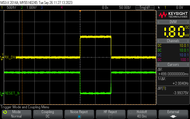

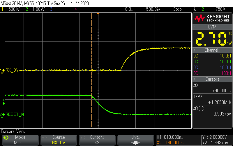

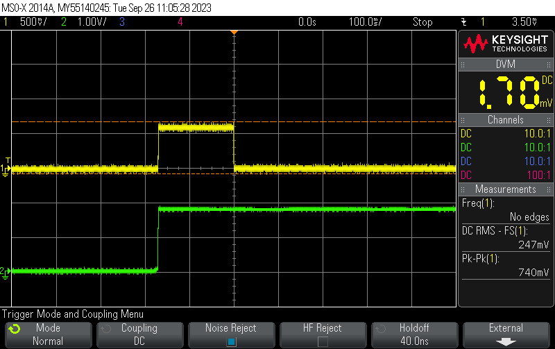

    From the image, you captured some pulse on RX_DV. Can you please capture the waveforms along with RESET_N so that we can look at timing of the pulse with respect to RESET_N?
    Gokul.
  • Hi Gokul,
    Thanks for your help
    Waveform:
    RX_DV vs RESET_N
    Close up
    RX_DV vs 1.8V
    RX_DV vs 3.3V

  • Hi Hezi,
    I am not able to conclude why straps are getting latched wrong from these plots.
    For strap resistors to be mounted for RGMII mode, please refer to section 8.5.1 in the datasheet.
    On MDIO register set, I can propose the registers. But the problem I see is that if the straps are latched wrong, PHY can go into RMII 50M mode by mistake and register access might not be available for you to change the MAC interface mode.
    Gokul.
