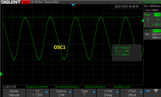

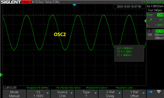

Debugging an issue with only some registers accessible and stumbled on his thread. Our crystal voltage too is between 0.25V and 1.2V, at least as measured with a passive probe, so it's likely adding some capacitance during measurements. We did not include series resistor placeholder in the design, and it is not practical to add it at this stage as the layout is pretty tight. What can be done with tweaking load capacitance and how does one go about that? Seems I'd start pulling the clock value away from the target.
Any suggestions are greatly appreciated!
Attached are our schematic and the plots of OSC1 and OSC2

    Do you by chance know how much capacitance your passive scope probe has?  I'm just trying to get a feel for what might be added when you are measuring the OSC2 waveform.  The plot shows a min voltage of 472mV which is much higher than the typical 100mV and 150mV max single-ended detection compartor threshold.
    You are correct that increasing the capacitance will shift the frequency, but generally this is not enough to violate the clock tolerance criteria in the CAN specification.  However, the allowed tolerance also decreases as you increase the bit rate, so this is somewhat application specific.
    The voltage levels are set based on the resistance and reactance of the components that create some voltage divider type of effects on the common mode levels.  The OSC1 side is generally lower than the OSC2 side, and this is also visible in your plots.  Some adjustment can be made to these common mode levels by simply adjusting the ratio of capacitance on the two sides of the crystal.  Increasing the capacitance on the OSC2 side and decreasing the amount on the OSC1 side by the same amount will keep the total capacitance the same, but increase the common mode voltage level of the OSC2 side.
    So, without adding a series resistor you could:
    1.) Try to increase both cap values equally and measure/verify the clock frequency shift is still within the CAN specification limits for your application
    2.) Shift capacitance to the OSC2 side by making the C12 = 10pF, and C11 = 6pF, or even C12 = 12pF and C11 = 4pF, etc. Then evaluate and verify the performance and check for stability.

  • Thank you, yes I did see the appnote but somehow missed the recommendation to have a placeholder Rd .
    As far as measurement- I am using a Siglent  SDS1104X-E scope with PP510 passive probes in 10X mode (https://assets.testequity.com/te1/Documents/pdf/siglent/siglent-probe-series-datasheet.pdf)
    so likely adding a non-insignificant amount of capacitance (18.5 pF-22.5 pF, 10M) to the circuit.
    Seems I need proper tools to even look at this without affecting the results, something like an active probe
  • Yes, the scope probes are going to add significant capacitance during measurement and you would not be able to observe a disruption to the clock circuit when the scope probe is attached.  Low capacitance active probes are needed to reduce measurement error for these type of measurements.
