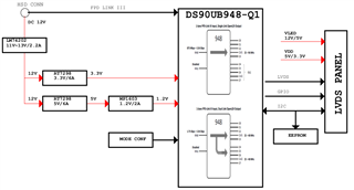

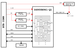

  • Hi Joe,
    I need to know more information about your system:
    1. Provide the system block diagram?
    2. What is the BC rate?
      1. Does increasing the BC rate improve the system?
    3. What is the I2C bus speed?
    4. Can you provide the I2C bus saleae capture when the screen is working properly and when the screen is lagging?
        => This is the question asking about.

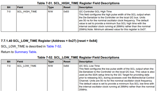

  • Hi Joe,
    Register 0x23 of the 948 is reading 5Mbps BC speed( 0x23 = 0x28). We can test a higher BC rate by changing this rate to 10Mbps and then 20Mbps.
    Change rate to 10Mbps by writing 0x48 to register 0x23.
    Change rate to 20Mbps by writing 0x18 to register 0x23.

    My SOC can only drive maximum of 375K of I2C frequency (2.7 µs/cycle).
    I notice that the UB948 SCL frequency is about 77K (13 µs/cycle).
    I modify the 0x26/0x27 of UB948 to 0x10, trying to shorten the SCL cycle.
    Looks like this solves my question.
    time 05M-change-SCL-sycle Native touch
    complete one touch
    4.951ms
    4.979ms
    complete 10 touches
    49.988ms
    48.704ms

  • Additional, these regs set to 0x25~0x10, gets the same result.
    Looks like the min cycle time is 4 µs.
  • Hi Joe,
    You are correct. Since you are using the I2C bus as 400KHz speed, the high and low pulse width of the SCL will not meet the default minimum so registers 0x26 and 0x27 need to be configured accordingly.
    For 400KHz  I2C speed:
    Period : 1/400KHz = 2500ns
    Clock High Time = 1250ns
    Clock Low Time = 1250ns
    1250ns / 50ns = 25
    Register 0x26 and 0x27 should be 0x19.
    Gil Abarca
