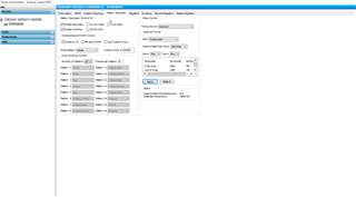

Hi Team,

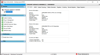

We have DS90Ux949 EVM and DS90Ux948 deserializer over the display panel.
Link formation between deserializer and video source work well.
Able to detect the EVM in ALP tools, and able to read the register of both devices.
For video input, host source over the HDMI, frequency and other parameters are verified. But nothing is displayed over the display.
Prior to debugging actual video output, we are debugging the test pattern generator, but not seeing anything displayed.
We tried multiple use cases, fix color bar, color pattern, video sourcing. not gone well.
Also, tried this combination with and without video source.
Note: We are using default setting provided in the user guide.
Please find the attachment of linking the devices.
Kindly let me know how we can work it

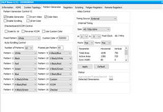

  • Hi Madan,
    Would you be able to confirm that you are sending Pattern Generation from the 949A to the 948 in your setup?
    Also:
    1. What does your Pattern Generator tab look like during attempted operation?
    2. What are the timing specifications of your display?
    Miguel

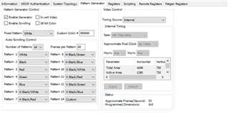

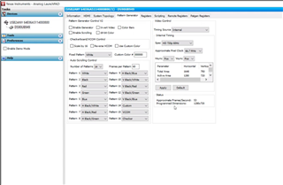

  • Hi Miguel,
    Please find the below details
    - Yes, we try send pattern generation from 949A, After click on the ÁPPLY' not able see any update.
    - Please find the attached screenshot.
    - Display support upto 1920x1080 @60Hz
    We are trying default 720p @60Hz.
    Also try pattern generation from the serializer and de-serializer

  • Hi Miguel,
    One observation noted, when toggle the enable generator checkbox, the apply option gets disable. Keeps time control internal.
    Can you share detail steps to be followed and Pattern Generator Control V2.
    We are using the recent 1.57.0010 ALP
    Madan
  • Hi Madan,
    Could you provide the screenshot of this behavior?
    For Pattern Generator, it will only consider the internal timing of the device since the pattern is locally generated on the SER and sent to the Deserializer. However, if you are enabling the generator and color bars and are not able to apply these settings, you may not see the output > to the DES > to the Display.
    Are you isolating the SER from input sources when running this test?
    Miguel
  • Hi Miguel,
    Please find attached screenshot
    Yes I have tried with isolation and without isolation SER input source.
    Madan
  • Hi Madan,
    Thank you for providing this info. Your ALP layout appears different than before, including HDCP Authentication tab (indicative of our UH devices), are you able to recreate this screen below for the 949 pattern generator configuration?
    You can select Timing Source - External under Video Control Panel
    Miguel
  • Hi Miguel,
    I have tried the mention steps and create the same setup.
    work around the timing source and pixel clock. For internal timing source option does not observe anything, but when change to external some observation notice, but it is not significant to capture in camera etc. only observe when room light is off and just notice very minor change. By looking front side won't see any pattern.
    White color bar pattern is set, and pixel clock set to 28.6MHz.
    Please let me know how we can work around it.
    Madan
