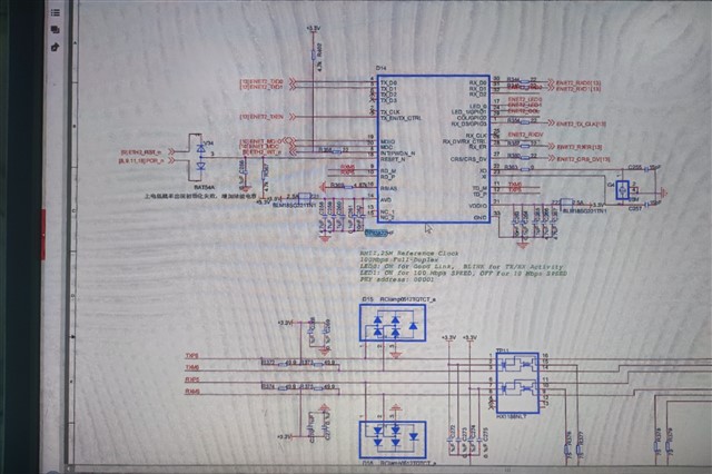

DP83822HF: when set to 100M, DP83822 will lose packet, but 10M is OK.
Part Number: DP83822HF
Dears:

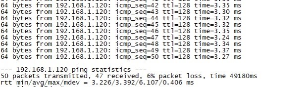

when set to 100M, DP83822 will lose packet, but 10M is OK. Could you please help check what need to be done to solve this issue ? Processor is imx6ull.
below is the configuration.

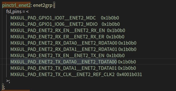

&fec2 {
                pinctrl-names = "default";
                pinctrl-0 = <&pinctrl_enet2&pinctrl_enet2_reset>;
                phy-mode = "rmii";
                phy-handle = <&ethphy1>;
                //phy-reset-gpios = <&gpio5 1 0>;
                status = "okay";
                mdio {
                                #address-cells = <1>;
                                #size-cells = <0>;
                                /*ethphy0: ethernet-phy@2 {
                                                compatible = "ethernet-phy-ieee802.3-c22";
                                                reg = <2>;
                                                micrel,led-mode = <1>;
                                                clocks = <&clks IMX6UL_CLK_ENET_REF>;
                                                clock-names = "rmii-ref";
                                ethphy1: ethernet-phy@1 {
                                                reg = <1>;
