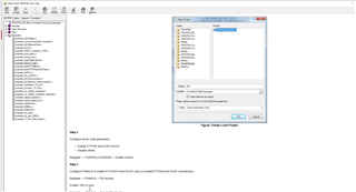

I  WANT  TO  USE  PWM  IN MY PROJECT   FOR  QUARATURE  PULSE GENERATOR   FOR  PULSE  PURPOSE  HOW  DO  THAT  , IAM  USING EXAMPLE  CODE  OF  TMS570LS4357  EQAP  , HOW  TO INCLUDE PWM  IN  OUR  PROJECT  WHAT  WILL BE  SET UP AND  CODE

    The PWM can be generated in two ways. One way is using ETPWM and the other way is using NHET.
    Using ETPWM:
    To learn this, refer the example codes present in the Help Topics section of HALCoGen
    Using NHET:
    In this method we have to use a special IDE called HET IDE.
    HET IDE User guide spnu483a.pdf

  • what u send  image its not  supporting ,can u send in  jpg form,  bro i have example code  quarature pulse  encode  for that input as pulse through PWM , how to include both example code

  • Hi Jeev,
