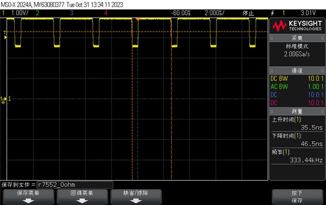

  • Differential output signal rise time: RL=120Ohm but it is not connected to the CAN bus, and the waveform is shown below.

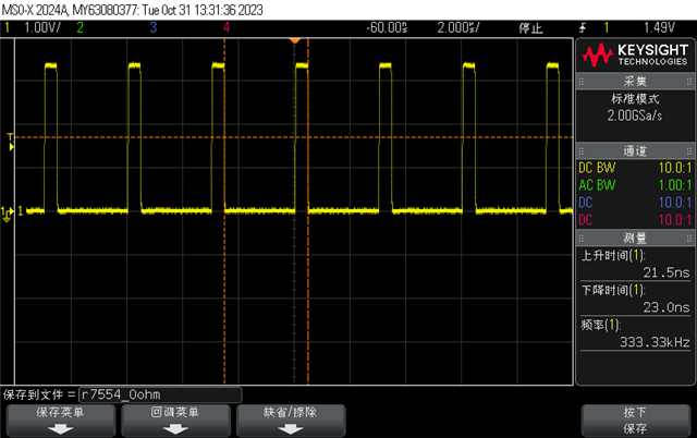

  • A 10-pF capacitor is placed in parallel with RXD, and the waveform is shown below.

  • Hi Imelda,
    The scope shots here look a bit too zoomed out to get accurate slew rate readings on these timescales. I would recommend zooming in on the scope to get better resolution on this behavior.
    The rise and fall times of the CAN signal are heavily dependant on the characteristics of the bus, particularly the differential resistive and capacitive loads. Because this test has different load conditions than is shown on the datasheet, I am not surprised to see some deviation from typical values. Given the conditions you describe, the values here look expected to me and don't indicate any issue with the transceiver or network.
