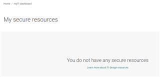

  2. Could your release all related final documents of DS560DF810 to us, include  Latte tool and Lib file of PG1.2 ? --> please find latest version of documnet, Latte, and C API  on mysecure. Let us know if you have any question about these.
