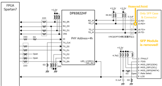

[Block diagram]
Since the SFP module was not inserted but was linked up, we suspected a change in the input signal of the DP83822HF and measured the waveform before and after the LED's changed.
Measured point:
 (1) LED_1/GPIO1 (SD_ IN): No problem (3.3 V fixed)
 (2) TD_ P: No problem (sine wave) * However, the measurement point is the 18pin of the SFP connector.
 (3) TD_ N: No problem (sine wave) * However, the measurement point is the 19pin of the SFP connector.
 (4) RD_P: LED does not light * However, the measurement point is the 13pin of the SFP connector (Measured Point section of the block diagram).
 (5) RD_N: No error (0 V fixed) * However, the measurement point is the 12pin of the SFP connector.
From the above, it was found that when an oscilloscope is connected to 13pin of SFP Connector, it does not occur.
Also, clipping the 13pin of the SFP connector with GND did not occur.
Therefore, the LinkUp factor is considered to be the input signal to TD_Ppin.

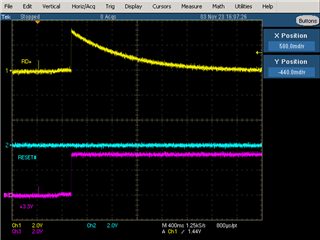

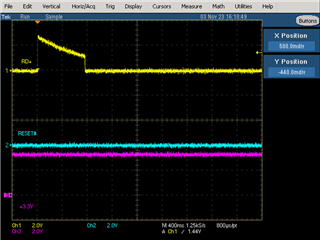

Further, the waveform measurement of the SFP connector 13pin was continued.
Discharge from 3.3 V to 0 V was confirmed when the oscilloscope was connected.
When the power is turned on while the oscilloscope is connected, discharge occurs immediately after 3.3 V is applied. (Fig.1)
When the oscilloscope is connected after power is turned on, discharge occurs from that moment. (Fig.2)
[Waveform] ch1: RD_P(SFP Connector 13pin), ch2: DP83822HF's Reset, ch3: +3.3V
 Fig.1
 Fig.2
As a guess, the AC coupling capacitor in the RD_P signal line is charged.
From there, the noise is fed into the RD_P pin, and it is considered to be a false detection of LinkUp.
*It is not possible to measure the waveform at the moment of noise because the phenomenon does not occur when the oscilloscope is connected.
In addition, it is not possible to directly measure the RD_P pin of the DP83822HF due to the mounting status of the component.
[Question]
 (1) Is this guess correct?
 (2) In the first place, are the termination circuits of RD_P/RD_N and TX_P/TD_N correct?
 (3) In the first place, what are the conditions under which the Linkup Status becomes Valid in the 100BASE-FX condition for DP83822HF?
      If the RD_P/RD_N signal fluctuates, is it valid?
     Or is it not just a fluctuation but a valid once the negotiation is completed?

    DP83822 is in a fiber application on a PCB where it is connected to a fiber case/connector with the actual SFP module unplugged. Power is applied to the case after the PHY is up, and somehow the PHY is detecting a pseudo linkup.
    Probing the line yields figures 1 and 2 with the latter being a later time behavior of the line (RX+). When probing the line, the behavior is not realized. When connected to GND, this behavior is also not realized. So the hypothesis is somehow the line is being biased in such a state undetectable with scope to give PHY a pseudo-good link indication.

    1) MDI termination looks fine.
