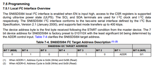

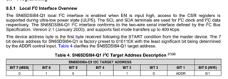

We are using TI SN65DSI84 Bridge chip on our custom board based on Renesas RZV2L processor. We are facing issue in detecting the bridge IC on I2C. Driver probing of SN65DSI8 fails with the below mentioned error.

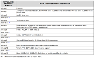

We want to know do we need the initialisation sequence as mentioned in section '7.4.3 Initialization Sequence' of datasheet for the detection of bridge chip on I2C. Or is it for proper operation after the detection of bridge chip IC.

[ 2.012826] sn65dsi83: probe of 2-002d failed with error -22
Below is the output of i2cdetect command , there is no device detected on the address 0x2d.
root@sm2s-rzv2l:~#
root@sm2s-rzv2l:~# i2cdetect -y 2
0 1 2 3 4 5 6 7 8 9 a b c d e f
00: -- -- -- -- -- -- -- -- -- -- -- -- --
10: -- -- -- -- -- -- -- -- -- -- -- -- -- -- -- --
20: -- -- UU -- -- -- -- -- -- -- -- -- -- -- -- --
30: UU -- UU -- -- -- -- -- -- -- -- -- -- -- -- --
40: -- -- -- -- -- -- -- -- -- -- -- -- -- -- -- --
50: -- -- -- -- -- -- -- -- -- -- -- -- -- -- -- --
60: -- -- -- -- -- -- -- -- -- -- -- -- -- -- -- --
70: -- -- -- -- -- UU -- --
