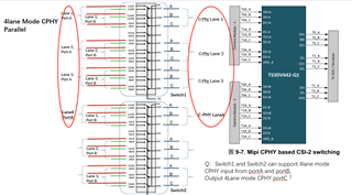

When I use TS3DV642 as a MIPI CHY mux with MAX96712,I have a problem- that the Ti mux just support 3lane mode CPY, but max96712 is 4lane CPHY,please see the figure below:

I'm not fully sure I understand, but it seems you are looking to use channel A and B at the same time. To compensate for the lack of lanes. This is not possible.
Please correct me if my interpretation is incorrect.

please see the figure, my problem is if the two muxs can be used in parallel so that can support 4lane CPHY(you can see the mux, channel A and B both just support 3 lane CPHY, but we must use 4lane CPHY).

Hello, Cheng,
Yes, I am assuming that all the switches will be TS3DV642. Depending on data rates and loss profile after the output of the final mux I would recommend the DPHY440SS MIPI retimer as well to compensate for additional insertion loss of each mux. What is the application? Please see this E2E thread https://e2e.ti.com/support/interface-group/interface/f/interface-forum/1191596/ts3dv520-cascading-4-channel-csi-from-four-inputs-to-one-output-using-three-2-1-multiplexers.

Hello, Kai,
I now understand that you want to break up the 4 lanes by putting 1 lane onto a separate MUX. The part to part skew for this part is not given in the datasheet and per the specification your inter-pair skew must be within +/-3.5 UI. If you break up the lanes, there is no way to guarantee that you can meet this requirement.
Also, unfortunately we do not have an automotive grade MIPI retimer solution.
