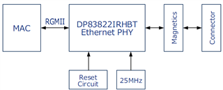

・The circuit configuration is based on the typical applications in the data sheet.

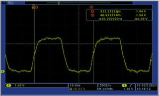

・25MHz clock is output from the [RX_D3/GPIO3] pin.
    → It is assumed that the shared pin was incorrectly set (extension register address 0x0462) during startup due to high temperature.

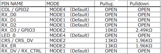

・There is no voltage fluctuation in BOOTSTRAP.
   ⇒We guess that the initial settings of the registers inside the PHY may be affected by something during startup at high temperatures, causing an error.

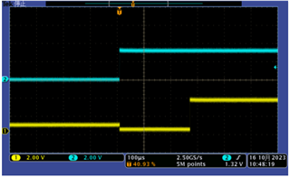

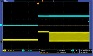

・The following is a comparison of registers for OK/NG. (Left: OK, right: NG)
・The [RX_D3/GPIO3] waveform of OK/NG is shown below. (Left: OK and 0x0462 data is 0x0001, right: NG and 0x0642 data is 0x0301)
    *Blue: PHY reset, Yellow: RX_D3/GPIO3
→Enlargement of NG waveform (25MHz output)
