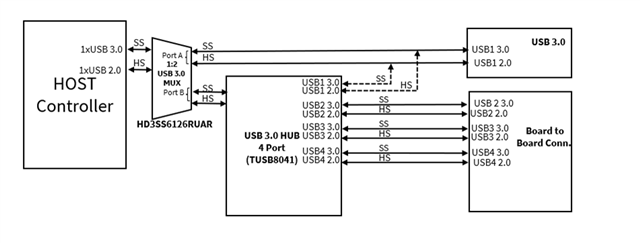

We have an USB 3.0 MUX requirements .Refer the below block diagram .
The HS & SS signals are the inputs to Mux from Processor or Host controller. We prefer to use one common USB 3.0 port to switch between the direct SS & HS signal (Processor) or from the USB 3.0 HUB. It requires to short or develop a stub at the output of the MUX & USB 3.0 connector.
We require concurrence from Ti that the stub or junction between the USB connector and MUX would not deviate the requirements?
When A port is selected what would be status of B port ? will it be in Hi-Z state?
Do advice if the below configuration would meet our requirements.
