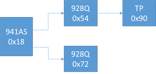

I used 941ASQ+928Q Left/Right 3D Format + LVDS Touch Panel
I2C Addr 941AS:8bit:0x18 ,7bit 0x0C
I2C Addr 928Q: 8bit:0x58 ,7bit 0x2C  8bit SlaveAlias:0x54 & 0x72
I2C Addr TP:     8bit:0x90 ,7bit 0x48
TP INT->928Q GPIO3-> 941AS GPIO3->SOC GPIOA
TP RST->928Q GPIO2-> 941AS GPIO2->SOC GPIOB

  • Hi Gene,
    In register 0x70, you have programmed the remote target ID, however you have not programmed an alias in register 0x77. If this value is left 0, it will disable access to the remote target. You can program the same value as the ID, but something must be programmed.
    Ben
  • Dear Ben,
    1、register 0x70&0x77 set 0x90 (Remote Device Slave ID)is same as before 。
    2、when the TX_AUTO_ACK bit of 941AS(0x03) is set,  928Q i2c write will loss byte.I disable the TX_AUTO_ACK bit SOC I2C speed set to 400KHz,and
    941AS&928Q I2C speed set to 400KHz, can write touch panel registers right. but I2C can't read right value  from touch panel .

  • Hi Casey,
    Thinks for your help !Now the touch panel can work!
    1、The Auto ACK bit of 941AS,need to be set 0. I2C PassThough can  normal work.
    2、928Q GPIO3 as RST PIN of touch panel ,the 0x1F register of 928Q need set to 0x05,but I set 0x09 before,output high level,so this pin can be pull down by touch panel driver.
