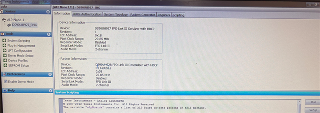

  • Hi Emily,
    Why are you using I2C address 0x6A for the deserializer? The ALP software shows that deserializer's I2C address is 0x58.
    What is the MCU I2C address?
    Can you also disable Demo mode and let me know if you can R/W to the 928 registers?
    Gil Abarca
  • Hi Gil
    Thank you for you reply.
    => Because my hardware design setting is 0x6A in 928. But I don't know why ALP recognized as 0x58 automatically.
    Could I set 928 I2C address as 0x6A using ALP?
    => MCU I2C address is 0xE2, Also can't be accessed.
    => I can not R/W to the 928 registers after removing the USB driver.
    I have no experience with 927-evm, Thank you very much for your more help.
  • Hi Emily,
    There are a couple of things that need to be done here:
    1. Update your ALP software. You can download it here.
      1. Download both the framework and the profile update.
    1. Disbable Demo Mode
      1. Demo mode is a simulation of the devices. Currently you are only doing R/W in simulation instead of the hardware. By default the software will set the simulated deserializer to 0x58. You disable it by unclicking Enable Demo Mode in the preferences section.
      2. You should be using the USB2ANY/Aardvark Setup to select the DS90UB927-Q1
    What you need to do is connect the 927 via USB with your computer and the 928 to the 927EVM via the FPD-Link port.
    Once you disable Demo Mode and chose the DS90UB927-Q1 profile you should be able to access the 927,928,and MCU as long as you have I2C passthrough enabled.
    Gil Abarca

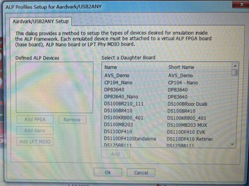

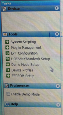

  • Hi Gil
    Thank you very much for your reply.
    I'm very sorry to trouble you.
    I have installed the new "Analog LaunchPAD" ,  open ALP→ disable Demo mode → click the "USB2ANY/Aardvark Setup"
    I found that the "USB2ANY/Aardvark Setup" can not add any device.
    Please see below picture: Add key all invalid, can not select.
    Shall I need to connect the "USB2ANY" board to DS90UB927QEVM?
    I don't have the "USB2ANY" board.  Is there any other way to connect it?

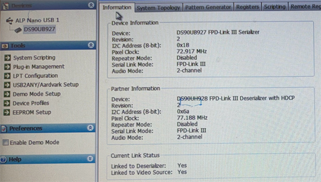

  • Hi Gil
    The ALP have connected successful.
    but the ALP connect to 927-evm with I2C, My signal generator aslo need to connect to 927-evm with I2C.
    my hardware connection: signal generator(LVDS+I2C)→ 927-evm→ FPD_LINKⅢ→ deserializier(928) and MCU
                                              ALP→ USB(I2C)→ 927-evm
    There have 2 Master I2C devices. I can not sent information from my signal generator to 927-evm when connected with ALP.
    Please kindly confirm how to do it. Can I use only ALP to write below information to 928 and MCU?

  • Hello Emily,
    Your SER has the I2C address: 0x18
    The DES has the address: 0x6A
    The way you need to use to write to the SER and DES is as following:
    Local communication:
    board.ReadReg(address, length) ==> Example: board.ReadReg(0x18, 1)
    board.WriteReg(address, value) ==> Example: board.WriteReg(0x18, 0x58)
    Remote communication:
    board.ReadI2C(Device address, Register Address, length) ==> Example: board.ReadI2C(0x6A, 0x00, 1)
    board.WriteI2C(Device address, Register Address, value) ==> Example: board.WriteI2C(0x6A, 0x01, 0x01)

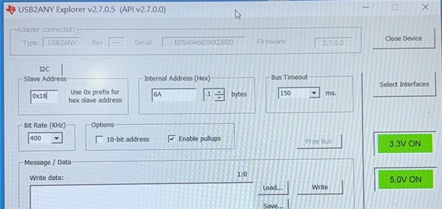

  • Hi Sir
    Thank you for you kindly support.
    I have some problem about USB2ANY.
    Now the hardware connection as below:
    PC(USB2ANY explorer v2.7.0.5 API V2.7.0.0) → USB2any board (SDA,SCL GND) → 927-evm board (SDA,SCL GND)→ FPD LINK3→ 928 and MCU
    step: 927-evm power on → 928 and MCU power on → open USB2ANY software → open device→ select interfaces(I2C) → 3.3V ON, 5V ON
    question1: Is the software and hardware connection method correct?
    question2: How to define slave address, internal address and write data?
    question3: How to write registers, what are the format about write and access the registers.
    question4: When I click "load ", what is the format of document. I want to create a new register document.
    My 927-evm address is 0x18, 928 address is 0x6A, MCU address is 0xE2
    example: I want to write 0x18 0x18 0x19, how to set ?
    JDIC Emily.

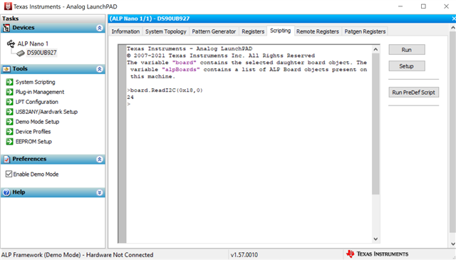

  • Hi Emily,
    Based off of your previous screenshot with ALP ("The ALP connection successful"), it looks like you can use ALP without using the separate USB2ANY module. The USB2ANY explorer is normally not used for reading and writing I2C commands. ALP is the recommended GUI for interfacing with FPD-Link products.
    Could you try this in the "Scripting" tab in the UB927 profile? If this method works, then we can disregard using the USB2ANY module.
    • Write "Board.ReadI2C(0x18, 0)"
    This will read from register 0 on the UB927 and return the I2C address in decimal form.
    The above screenshot is in demo mode since I do not have a UB927 but should have similar results for you if the USB drivers are working correctly.
    In the scripting tab, write "Board.WriteI2C(0x18,0x18,0x19)"
    The 928 I2C address will automatically be recognized by the 927 in register 0x06
    To set I2C pass through and setup communication to MCU:
    Board.WriteI2C(0x18,0x3,0xDA)
    Board.WriteI2C(0x18,0x7,0xE2)
    Board.WriteI2C(0x18,0x8,0xE2)
    Jack

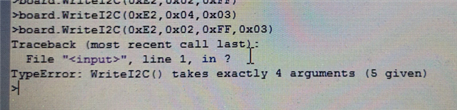

    But I have one question:
    In 0xE2, 0x02, 0xFF, 0x03  , there have 2 parameters(0xFF,0x03) need to write in 0x02 register.
    I can not run  "Board.WriteI2C(0xE2,0x02,0xFF,0x03)"
    How about the write format of 2 values?
    Thank you very much.
    JDIC Emily
  • Hi Emily,
    The board.WriteI2C() command only writes 1 byte at a time. In order to write 2 bytes to the same register in the MCU you will need to do the following.
    data = 0xFF03 // 16-bit data
    board.WriteI2C(0xE2,0x02, data>>8) // MSB of data
    board.WriteI2C(0xE2,0x02, data & 0xFF) // LSB of data

  • Hi Emily,
    1, I already run all command, But it seems that this command(0xE2 0x02 0xFF 0x03) does not implement the function.
    In order to write multiple bytes to the same I2C register address use the command
    • board.WriteI2C(0xE2, 0x02, [0xFF, 0x03])
    The data in the brackets will be written to the register in a single I2C transaction.
