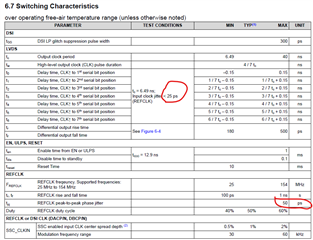

One more question hope to discuss with you. as you mentioned we can use REFCLK cycle to cycle jitter as workaround for LVDS CLK cycle to cycle jitter.
SN65DSI83 provide REFCLK phase jitter, max 50ps (as figure1). according to the relationship between cycle to cycle jitter and phase jitter, as figure2, the max REFCLK cycle to cycle jitter should be 200ps (??), so we can use max 200ps as LVDS CLK cycle to cycle jitter for workaround, right? thanks a lot.

1. as cycle to cycle jitter is to do second derivation for phase jitter, so cycle to cycle jitter pk-pk value is less than phase jitter pk-pk value, and need know phase jitter function to generate cycle to cycle jitter. But now we don't have this phase jitter function, can we use phase jitter pk-pk value (50ps or 25ps) as cycle to cycle jitter? Or other workaround?

cycle to cycle is best at comparing adjacent clock cycles but isn't good at determining a pattern between non-adjacent clock cycles. Phase and period jitter are better at standardizing clock frequency. If you use the phase jitter as the cycle to cycle jitter this application should work, as it is more stringent.

Hope to consult you for one more question: as LVDS CLK cycle to cycle jitter is not available now, the workaround is to use REFCLK phase jitter as an alternative, then should we use 25ps or 50ps phase jitter more reasonable as below datasheet table? Maybe 50ps is too pessimistic as cycle to cycle jitter is much smaller than phase jitter, so what's your opinion?
thanks
wenjun
If you are looking to calculate the jitter for the LVDS side, I would say using the 25ps will be the closer approximation.
