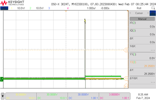

    In the following plot you can see the voltage on the CAN lines:
    Are theses the same devices?
    Yes the power supply was active before the connection to the CAN bus made.
    The transceiver is assembled on a BMS for battery protection. The BMS is connected to the battery. The BMS is in sleep mode, so the transceiver is not supplied. Then I use a voltage supply which is switch on and connect it in short times to on of the CAN Lines with respect to GND. First it was the CAN Low line. After the first connection the transeiver was defect.
    Please see the Osziplot:
    The yellow line is CAN Low and the green line is CAN H.

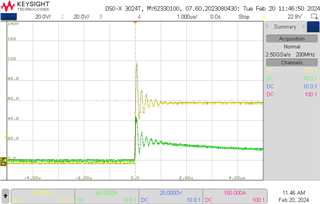

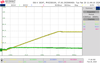

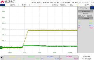

    I repeated the test with two different power supply. And I used the OutputON Switch of the Power Supplies.
    Here is a plot of the first one:
    chanel1: CAN_H with releation to GND
    channel2: CAN_L
    And here the other one:
    channel2: CAN_L
    The second one has a slower ramp. But it worked with both power supplies.

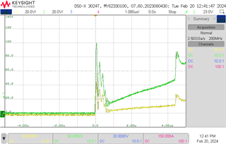

    If I first switch on the power supply an than connect it to CAN_H ist looks like this:
    channel2: CAN_L
    I madea second try on CAN_L and the TCAN was defective:
    channel2: CAN_L
    You can see voltage transients with 100V. I think that is the reason for the defect.
